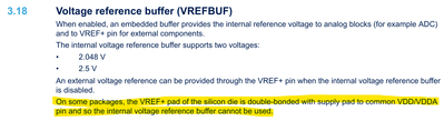

Your chip doesn't have a dedicated VREF+ pin and so you cannot use the VREFBUF at all.

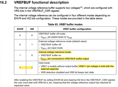

Hold mode is for low power applications where you want to disable the buffer but keep the voltage. It's not relevant here.

This chip does not have a separate VREF+ pin. Its VREF+ pin is tied internally to VDDA. Because of this, you cannot use VREFBUF on this chip.

Thank you for your response. I was confused about using the DAC due to the following:
 I expected that in HOLD mode, it would be possible to use the internal REF_V in the DAC.
Could you please clarify once again? Is it not possible to use the internal REF_V (2048mV) as the reference voltage for the DAC or ADC on the STM32U073RBT6?
