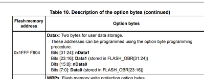

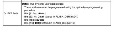

This is what the reference manual is saying. It's accessible over this address: 0x1FFF F804
But it can contain only two bytes and their opposite (Datax and nDatax) and you need 4-bytes storage!
In the CubeProgrammer I've written 0x12 in Data0, 0x78 in Data1:
Read in software:
key = *(uint32_t*)0x1FFFF804;
key contains 0x8778ED12
ED the bitwise inversion of 12 and 87 is the bitwite inserion of 78.
Read in software:

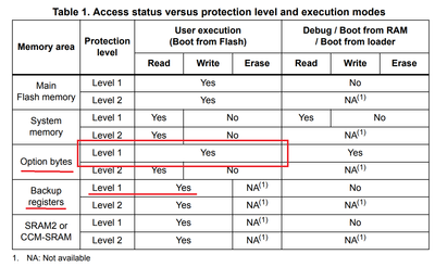

Since, you mentioned BitInversion, will it automatically inverted while storing this two byte in Option memory ?
If we enable RDP1 , will this two byte as well be read/Write protected ?
Yes. It's automatically inverted. The inverted values are not accessible by the user. I think it is used mainly to check the consistency.
@bsuthar wrote:
@mƎALLEm , This is useful.
Thank you,
Emm that's a good question. I'm not expert of security subjects. You can ask it in the STM32 Security forum but according to the AN4758 "Proprietary code read-out protection on
STM32L4, STM32L4+, STM32G4 and STM32WB Series"
Both Option bytes and Back-up registers are accessible at RDP1. So I think you need to use the internal Flash. No way ..

"Both Option bytes and Back-up registers are accessible at RDP1. So I think you need to use the internal Flash. No way .."
Are you pointing out because of limittaion of 4 byte storage ?. we can shrink Key to 2 byte to be stored in Option Byte.
2025-10-28 4:02 AM
@bsuthar wrote:
@mƎALLEm ,
No, I'm saying that option bytes are not protected by RDP1. Please read my previous post. Meanwhile you can confirm by asking that question in STM32 Security forum as I'm not a security expert guy.
