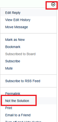

Did you really accept the solution?
2025-10-28 10:07 PM
2025-10-29 1:21 AM
In next time please don't mark the solution as it was not solved. If it was mistakenly done, you can unmark it using this arrow:
