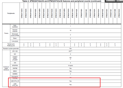

Considering USB 2.0 HS & FS operations are different from USB 2.0 HS & FS OTG operations, Correct me if I am wrong
2025-05-20 4:12 AM
It shows that STM32H743BIT6 supports only FS operations, why?
You need to provide the document from which you captured that screenshot.

As I said previously STM32H743 has both High speed and Full speed USB OTG interfaces. You need to refer to the datasheet of the product. There is may be a typo in the AN4879.
2025-05-22 4:37 AM
That was not a typo. H743 and H750 have the same USB configuration.
USB_OTG_HS is listed as supported interface on the STM32H743 product.
