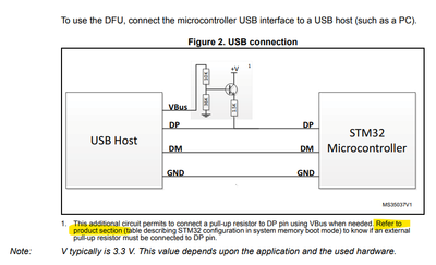

Hello, In our project we are planning to use STM32H743BIT6 uC, we are using USB for flashing the firmware and to download the logs, not at the same time, if we connect DM & DP lines from uC PA11 & PA12 pins to USB microAB connector DM & DP lines, will that be ok? Or any other HW support required?
Which is the product section table for more clarity?

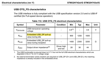

You do not need a pullup resistor on the STM32H7. Just connecting DM and DP will work.
Introduction to USB hardware and PCB guidelines using STM32 MCUs - Application note
It is no doubt listed in several locations. Here's one of them.
