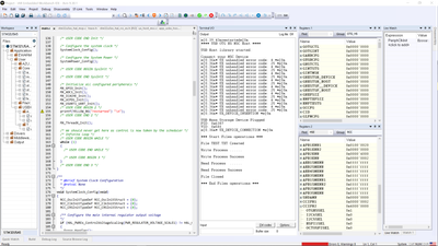

The second screenshot presents OTG_HS-related registers' state after when MX_USB_OTG_HS_HCD_Init() function was finished and HAL_HCD_Start() function was called.

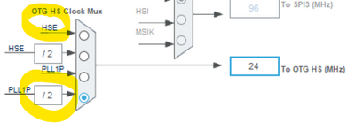

Have you clicked the "PLL1P" option in the mux in CubeMX, as @TDJ has shown in one of the first posts above?
TDJ
Lead
@FBL@waclawek.jan Exactly, the code I shared was working correctly.
Now, to reproduce the problem select PLL1P as OTG clock source without /2 divider and decrease PLL1P frequency to 50%.
