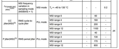

IP clock source selected is not compliant with 400ppm. Since, the source for PLL1P clocked with MSIS.
According to the datasheet, MSI output characteristics are stated as follows.
According to the reference manual, section 11.4.19 OTG_HS clock, MSI is not suitable for this USB OTG HS use case.
I hope this helps!
