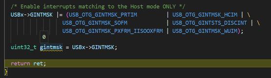

At the end of this function, host mode events are enabled using GINTMSK register (RM0456, section 73.14.8 OTG interrupt mask register [alternate] (OTG_GINTMSK), offset 0x18).
USBx->GINTMSK |= (USB_OTG_GINTMSK_PRTIM | USB_OTG_GINTMSK_HCIM | \
USB_OTG_GINTMSK_SOFM | USB_OTG_GINTSTS_DISCINT | \
USB_OTG_GINTMSK_PXFRM_IISOOXFRM | USB_OTG_GINTMSK_WUIM);
The problem I found and cannot explain is that after when this line is executed, GINTMSK register value is still zero. Other OTG_HS registers get correctly set so probably the problem is NOT caused by misconfigured or not enabled RCC AHB2 peripheral clock (RM0456, 11.8.30 RCC AHB2 peripheral clock enable register 1, bits 14 & 15 - OTGEN & OTGHSPHYEN flags).
Please advise, I start to suspect some hardware bug or incorrect GINTMSK register offset.

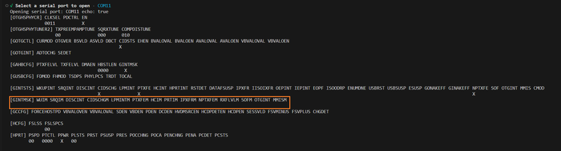

Probably a separate issue is that GAHBCFG.GINTMSK register flag is not set (Global interrupt mask, RM0456, 73.14.3).
The second screenshot presents OTG_HS-related registers' state after when MX_USB_OTG_HS_HCD_Init() function was finished and HAL_HCD_Start() function was called.

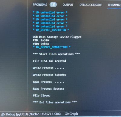

@ABOUA I have to say that I was skeptical since what I try to accomplish is USB host app, not device, but I gave it another try and for the first time it worked - I was able to save text file on USB-C pendrive using Nucleo-U5A5ZJ-Q. Now I need to understand what made the difference because I have tried porting the original examples more than once following the original code and flow to the letter. Most likely USB clock source is the culprit. Thank you for the encouragement.

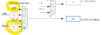

@ABOUA I am showing that USB OTG_HS works as long as HSE 16 MHz or PLL1P with /2 divider is used as a USB clock source. I successfully tested it with PLL1P 32, 40, 48 and 64 MHz frequencies, PLL1P clocked with MSIS 16MHz CRS-SYNCed with LSE 32.768 kHz. It repeatedly and consistently does NOT work with PLL1P without /2 divider - which exactly is the USB clock setup I have tried until now.
Is it a known problem, just not described in the device errata yet or some CubeMX bug?
Is USB OTG_HS particularly sensitive to clock signal condition and /2 divider, probably placed close to the IP within the IC, preconditions it? It may explain why GAHBCFG.GINTMSK register value did not write which, regardless of proper initialization sequence, should not have happened. It is important to understand what happens because I try to avoid using HSE. I use Nucleo-U5A5ZJ-Q just as a common test platform. The actual design is custom.

Hello @ABOUA, I am well aware that OTG_HS PHY takes only the listed frequencies. CubeMX shows an error if the effective frequency it is not one of the supported ones and I know that the selected clock frequency needs to be specified again in the IP config property. Probably I should be more specific here.
The problem I try to describe is that my tests repeatedly show that it makes a critical difference whether, for example, PLL1P frequency is set to 64MHz and /2 divider is used or PLL1P frequency is set to 32MHz and /2 divider is not active. In both cases the effective OTG_HS PHY clock frequency is 32Mhz, but in the the first case USB works while in the second case it does not, and symptoms are those I described initially. In another words, /2 divider must always be used.
I think, this may indicate a serious problem.
