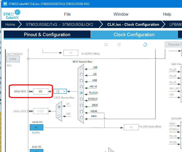

I've generated a project based on your ioc file and tested it and I can see 60Mhz on PA8
And the IOC file does, indeed, have MCO configured as 60MHz:
So back to @KnarfB's suggestion that the problem is with your measurement
You never did answer his question:
@KnarfB wrote:Does your LA have enough sample frequency or do you see an alias frequency?
