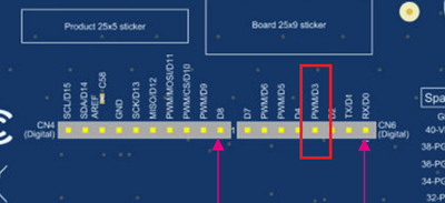

2025-07-17 2:42 AM - edited 2025-07-17 2:43 AM
Are you sure you are probing MCO on Arduino connector CN6/pin 4:

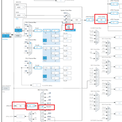

Where is MCO in your clock settings diagram?

2025-07-16 7:38 AM - edited 2025-07-16 7:41 AM
I suppose 60MHz is your HCLK clock?
If yes, did you set this configuration?:

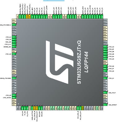

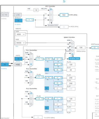

2025-07-16 8:55 AM
This is my ioc file
