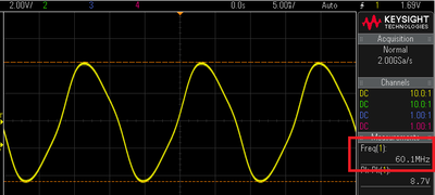

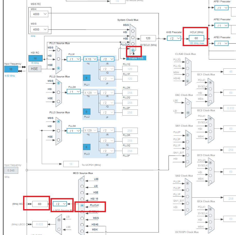

I've generated a project based on your ioc file and tested it and I can see 60Mhz on PA8 with a STM32U5G9J-DK2 board:
