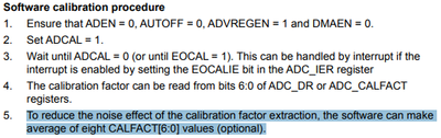

Coming back after check internally. What I provided is not the explanation for the implementation of the calibration procedure in the HAL driver.
The correct explanation is what we provide as step 5 of the Software calibration procedure in STM32C0 reference manual RM0490:
The same should be done in the STM32G0 reference manuals. An internal request is tracked for this purpose.

Hi Jan,
