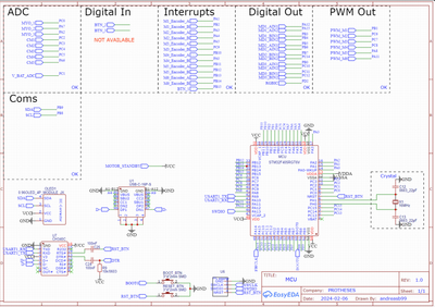

I have a custom PCB which has an CH340C (U7) serial chip and a USB-C (U1) port. See wiring diagram:

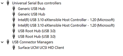

The problem is I cant find the Serial Port for my USB-C in the Device Manager.

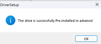

I have installed the CH340C driver and it is up and running on my pc. Link to driver:

No: things on the PC just see a COM port - they neither know nor care what hardware lies behind it.
If the COM port is not appearing in Device Manager, then nothing on the PC can see it at all.
This is nothing to do with ST - it's all down to the CH340C.

I see, then the fault must be in the driver or someting hardware. I have however measured the connections between the STM32 (RX/TX) and the serial chip (CH340C).

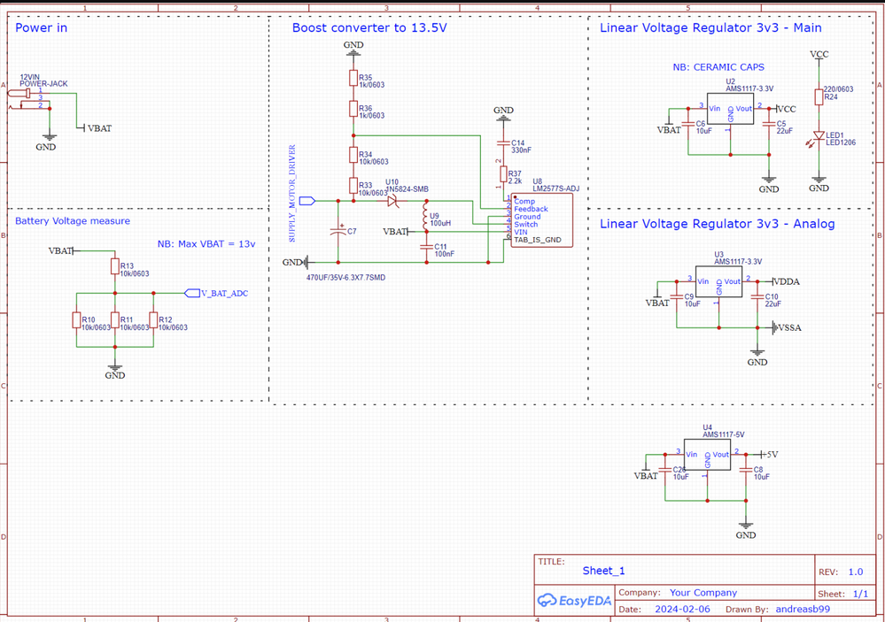

The VCC power suply comes from a linear voltage Regulator 3v3 (U2). See wiring diagram.
