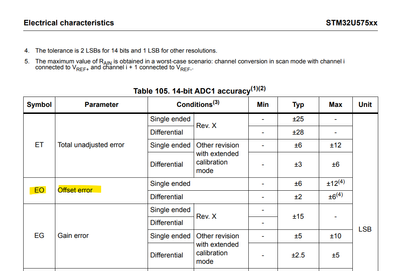

2026-02-11 2:24 AM
Not really. Remark (2) from the datasheet cutout you show tells:
2. ADC DC accuracy values are measured after the internal calibration
but which of both possible calibrations is meant?
2026-02-11 2:45 AM
Hello @Uwe Bonnes ;
Concerning note 2. ADC DC accuracy values are measured after the internal calibration
Standard calibration for Rev. X
Extended calibration for other revision
Thank you for your contribution in STCommunity.
Kaouthar
