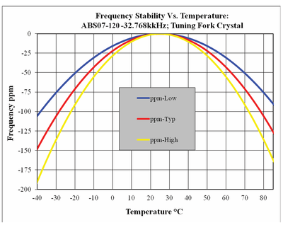

I'm developing a device with these requirements:
Ideally, we would like to get our total clock drift under 10 minutes/year (20 ppm) if possible.
I created one prototype using an Abracon 32.768kHz crystal for the LSE, with two C0G 6pF load capacitors. To test the prototype, I routed the LSE to the MCO1 and measured the clock frequency as we swept the temperature from -20°C to 70°C in our temperature chamber. I measured that and compared the ppm deviation to the expected deviation given by abracon (ppm = (T-25°C)^2 * (-0.035ppm)):

So, my next steps that I was planning was to:
However after doing some research, I'm a bit less confident about my approach
Is it feasible to tune a RTC like this to achieve 20ppm accuracy over a wide range of temperatures using only software? Or am I better off getting something like a temperature-controlled oscillator?

From the crystal datasheet, the range in accuracy varies by more than 20ppm over the 20-70 temperature range. Note the delta from the blue and yellow lines.
So that's not a viable solution unless you have the tools and time to calibrate each crystal independently.
You're better off with a TCXO.

Ah, yep. That's a good point, I should have noticed that.
In general, is this a viable strategy, assuming a wider ppm accuracy is acceptable?
Thanks
2026-01-21 6:54 AM
It's an okay strategy if the temperature is stable. It's not going to give you the accuracy of a TXCO though.
Your code will be more complicated, and you will use more power, it will be less accurate (compared to TXCO), but it will be cheaper in parts cost.
