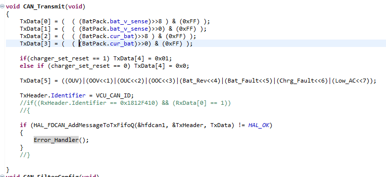

how are you initialising the peripheral?
show us the code, are you configuring your stm32 canbus peripheral to run at 250Kb? because thats the baudrate set in your microchip tool

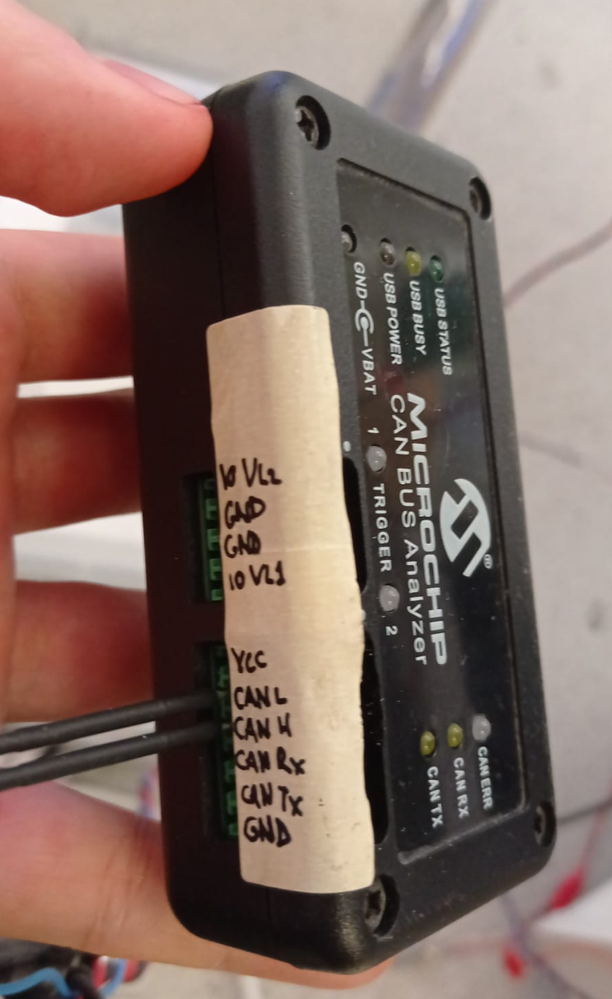

how are you wiring the canbus analyzer?
I do have the same ans i wire it like this. (triple check you did connect canH and canL where they belong)

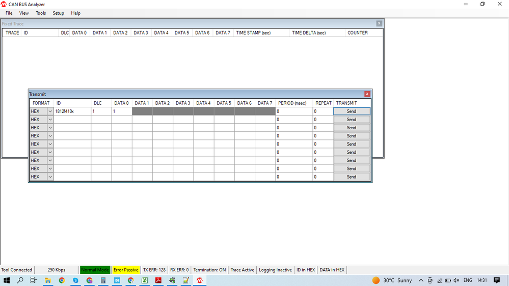

I have connected proper connections. For me CAN receive is working but getting error at CAN transmit.
Can receive from the stm32 is working and can sending from the stm32 is not working?
its a good habit to check if the canbus mailboxes are full before trying to send anything.
How are your canbus mailboxes doing?

aLSo, are you trying to CAN_Tramsmit inside an interruption¿

thank you for your response, Issue is resolved.
I am using the Polling method for CAN transmit..
