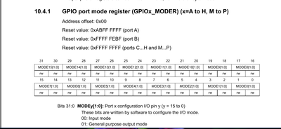

MX will initialize the port as either input or output depending on what you choose. That is all it can do. Do whatever you want with it after initialization. This includes switching between input and output using HAL_GPIO_Init.
If you are more familiar or prefer register access for any reason, modify the relevant bits of the GPIOC_MODER register directly. That is what actually controls the behavior of the chip. The reference manual has details on how this operates.

So just write to the mode register...in or out .
And set in Cube the port as input, to avoid problems at startup with conflicting settings.

I assume I may also read/write directly to the port: IDR/ODR ?
2025-12-25 9:57 PM - edited 2025-12-25 9:58 PM
Yes, a direct write to the port registers or read is the fastest way to get or set a port.
And if you want just set or reset one bit ( or more) then there is a register for setting and resetting bits in one single write access, just look at the port register description in RM.
