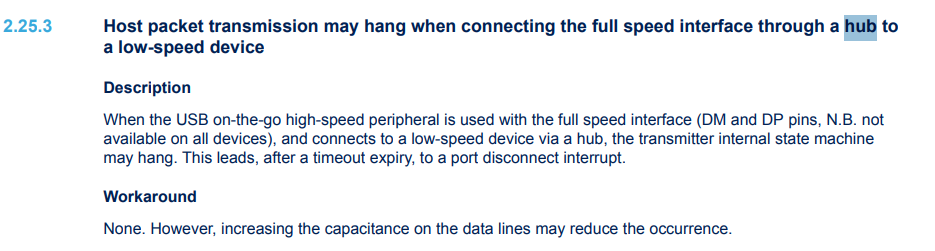

1. Indeed we have an errata saying: 2.25.3 Host packet transmission may hang when connecting the full speed interface through a hub to a low-speed device. So yes, this issues does not imply to Full Speed devices.

So just to recap, USB hubs may be used in FS mode but packet transmission may hang and require reconnecting to the port and ST's classic core middleware will not work and a different middle ware like USBX must be used?
The error is limited to cases when a low-speed device (e.g. typically a keyboard or mouse) is connected to the hub. If you are sure only full-speed devices will be used, e.g. if the devices are fixed, or are unlikely to be LS - as is the case of MSC ("memory stick") where no commercially produced device is LS.

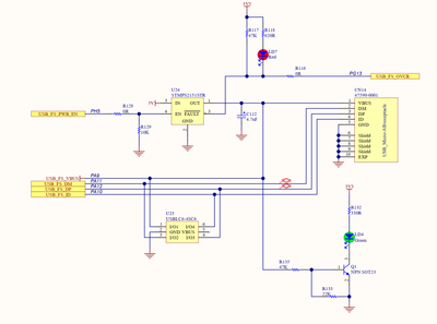

Looking at the schematics for the STM32H735 USB connector it shows PA9 connected to both Pin 1 of the connector and the output pin of the Power Switch. How is this "controlling" the Power?
2026-01-12 9:23 AM

2026-01-12 9:26 AM
I'm sorry, I meant to say STM32H735G-DK Discovery Kit. Here is a screen capture of the relevant page:
2026-01-12 10:29 AM
That Disco is to showcase OTG, i.e. possibility to use the STM32 as both Device and Host. In Device capability, it needs to sense VBUS, in Host, it may need to switch VBUS.

So does that mean then that PA9 doesn't do anything in HOST ONLY mode? The control of the power switch enable pin is handled by a different signal (PH5 on the disco board) and when using the USB2422 Hub it has it's only enable output signals for each downstream port. STM32CubeMX allows the Vbus pin to be activated in HOST ONLY mode by drop down menu, what does this do? Should I just deactivate the VBus pin and let it be GPIO?
The USB protocol has seen several confusing updates during its existence, one of them was related to OTG and role changing. This involves two marginal sub-protocols, SRP and HNP, both of which are implemented in the OTG module used in STM32. PA9 = OTG_xx_VBUS pin is an input to a comparator (more precisely, two comparators), which is used to indicate changes in power within those sub-protocols (as they allow either of the parties to assume the power-supplier role, regardless of their data role). As USB host states subchapter in the OTG chapter in RM states:
When HNP and SRP are both disabled, the VBUS sensing pin does not need to be
connected to VBUS.
This is your case, as you want to be a "plain old" Host which is the sole provider of the VBUS power, with no alternative powering schemes. However, the libraries (Cube/HAL/LL/whatever) and related clicky (CubeMX) may cater for the HNP/SRP, too, in which case you need to enable OTG_xx_VBUS pin and subsequently handle the HNP/SRP protocol.
Note, that I don't know the reasons, I am just speculating. I am not ST insider and I don't use Cube/CubeMX.
