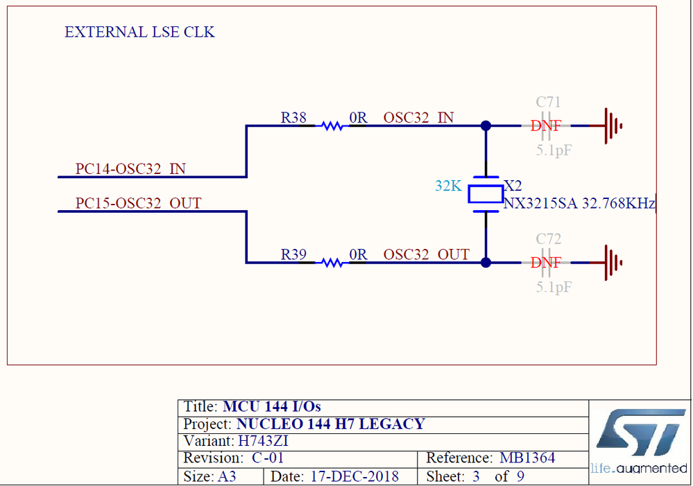

2024-01-15 12:34 AM
I bought one Nucleo-H743ZI2 board and found the two capacitors (C71 and C72) for X2 32.768KHz are not installed. May I know if I need to install them with 5.1pF if I want to use the X2? I went through the manual "UM2407 User manual for STM32H7 Nucleo-144 boards (MB1364)". But it seems not mention the two capacitors for the LSE clock. Thank you.
