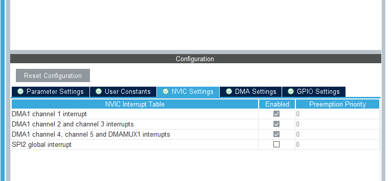

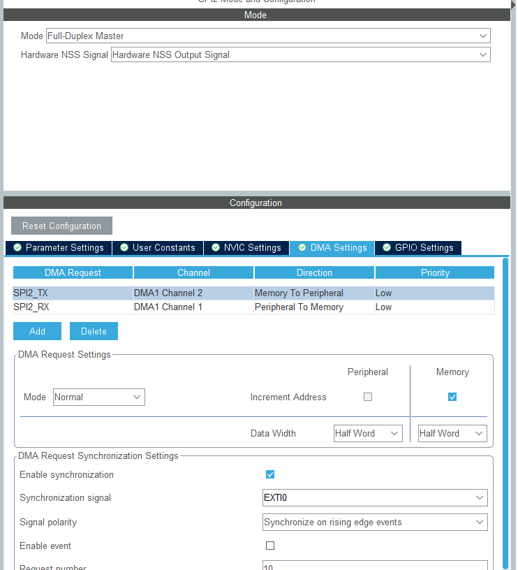

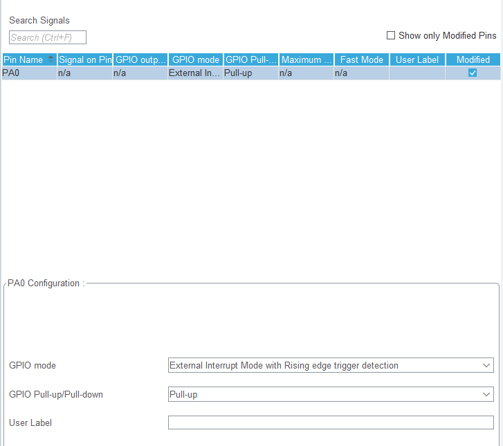

Pin A0 configured as EXTI0
SPI DMA settings
SPI NVIC settings
my code is like this
