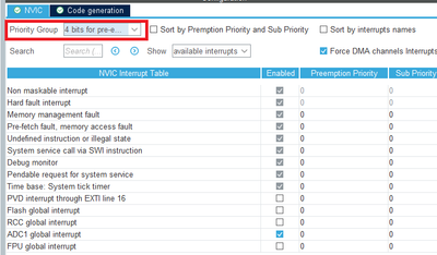

Perhaps you don't have any bits available for preemption priority. What priority group are you using? It's not shown in your screenshot, perhaps it needs resized to fit.

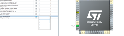

on F411 , i tried nvic -> dma priority to 3 :
and ADC to 5:
no problem. (just mouse click on the field ..)

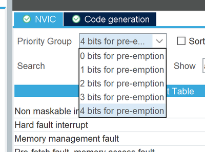

What is the Priority Group you've selected for NVIC?
