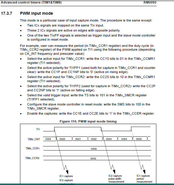

Take a look at this approach from St
It's from RefManual of F4 series
After you start HAL_TIM_IC_Start(..) you can continously read the captured values of CCR1(Period) and CCR2(Pulse width)
There is an example also in F4 firmware (HAL) for PWM Input.

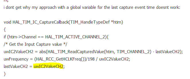

i dont get why my approach with a global variable for the last capture event time doesnt work:
void HAL_TIM_IC_CaptureCallback(TIM_HandleTypeDef *htim)
{ if (htim->Channel == HAL_TIM_ACTIVE_CHANNEL_2){ /* Get the Input Capture value */ uwIC2ValueCH2 = abs(HAL_TIM_ReadCapturedValue(htim, TIM_CHANNEL_2) - lastValueCH2); uwFrequency = (HAL_RCC_GetHCLKFreq())/198 / uwIC2ValueCH2; lastValueCH2 = uwIC2ValueCH2;}
if (htim->Channel == HAL_TIM_ACTIVE_CHANNEL_1){
/* Get the Input Capture value */ uwIC2ValueCH1 = HAL_TIM_ReadCapturedValue(htim, TIM_CHANNEL_1) - lastValueCH1; uwFrequency = (HAL_RCC_GetHCLKFreq())/198 / uwIC2ValueCH1; lastValueCH1 = uwIC2ValueCH1;}
}Please ignore the HAL_TIM_ACTIVE_CHANNEL_1 branch, its currently not executed because nothing is connected tpo the pin.

2017-09-11 7:55 AM
Hi
with a first glance, at this part of code
you assigned to lastValueCH2 the difference and not the last captured value.
The result finaly is not correct.
Also there is not need to take the absolute value of difference. you may treat all variables as unsigned and the result will allways correct. (0xFFFFFFFF+5=4 , 4-0XFFFFFFFF=5 for 32 bit operations or 0xFFFF+5=4 , 4-0XFFFF=5 for 16 bit operations)
