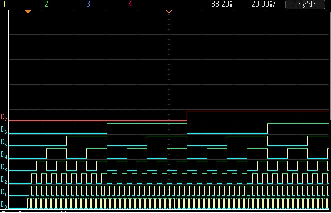

Hello and sorry for the late answer.
Unfortunately you didn't provide your complete config but I created a project were DMA is performing a transfer of 256 patterns (bytes) to GPIOD on NUCLEO-U575 (just PD0 to PD7). The patterns are the numbers from 0 to 255.
Attached a project were TIM32_TRGO is triggering the DMA for the data transfer.
These are the signals on PD0 to PD7:
Hope that answers your question.
