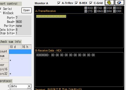

I'm trying to test with simple UART as the below code,
I connect with RS232's TXD to GPIO_Pin_10 and
RS232's RXD to
GPIO_Pin_9.
There is no problem RS232 kit, but I can't receive data correctly from kit.
I always receive data '00'. I don't know what am I supposed to resolve this problem.

USART_Cmd(USART1, ENABLE);///////////while (1) { USART_SendData(USART1,'c'); }}I can receive the '00' data , when I push the reset button in stm32F429 kit.
Would you please let me know what am I missing ?
