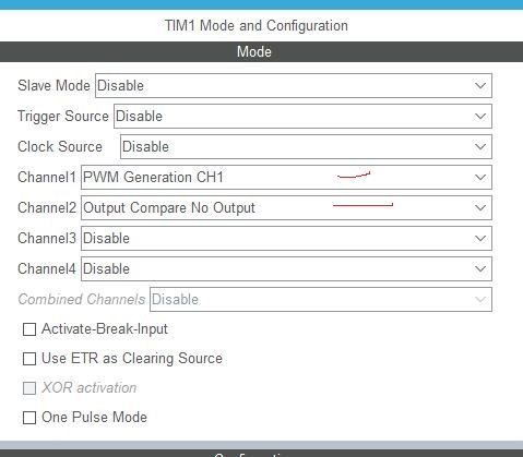

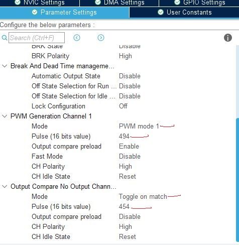

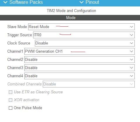

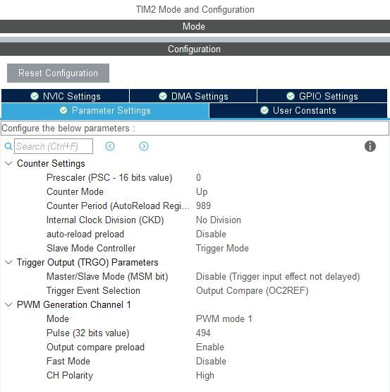

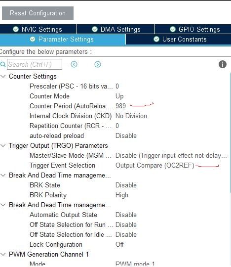

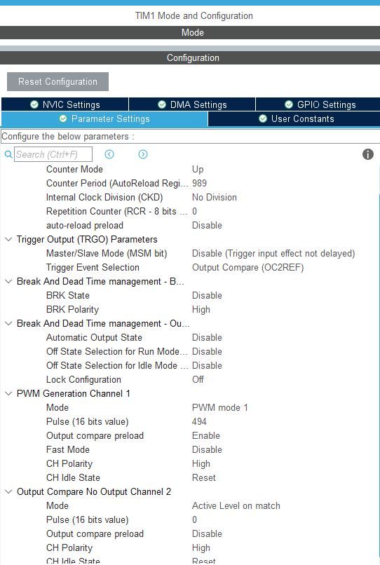

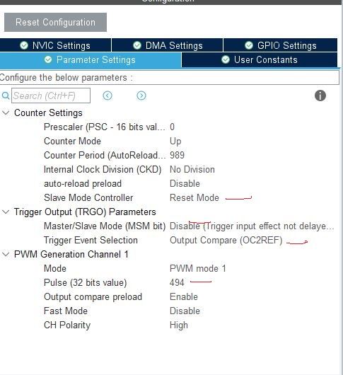

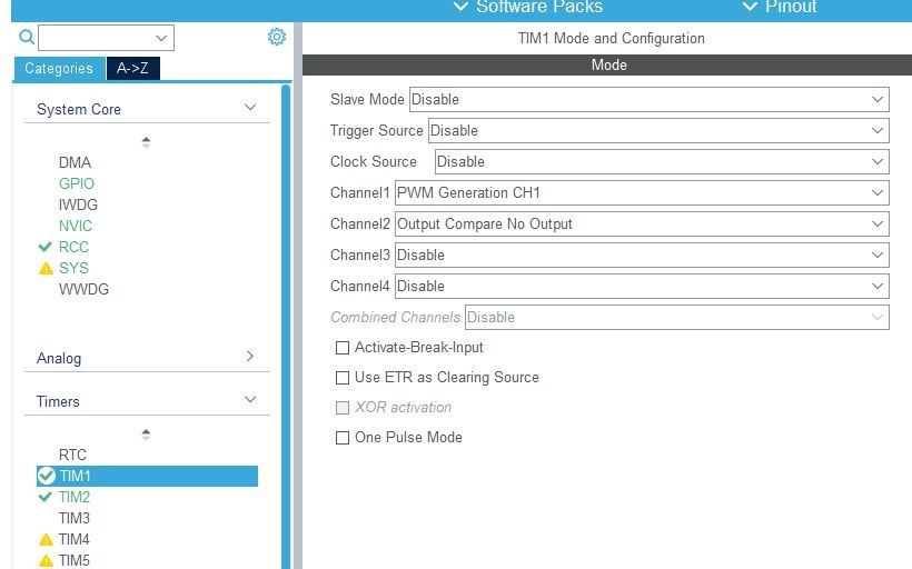

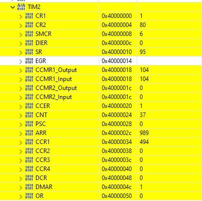

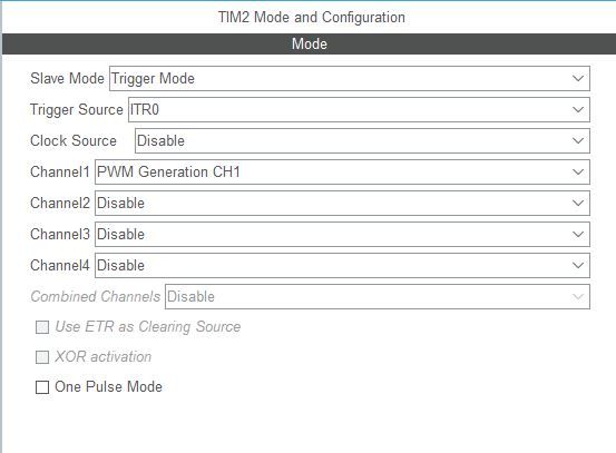

I'm new to using STM32 boards and coding with STM32CubeIDE. I have a simple task: generating two PWM outputs and adjusting the phase difference between these two PWM signals at runtime.
I'm using an STM32F407 board, and from what I've gathered through online research, I need to use two timers, one in master and another in slave configuration. For the master Timer (Timer 1), I've set up two PWM channels. Channel 1 of Timer 1 is for PWM generation, and Channel 2 of Timer 1 is for triggering Timer 2, which is set to 'output compare no output' mode. I followed a tutorial on YouTube (Timer Sync Tutorial ) to configure these channels.

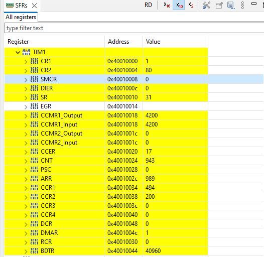

The pulse value set in TIM1 CH2 is supposed to change the phase of the PWM generated by Timer 2. However, I'm unable to change the phase at runtime. I've tried changing the value of the CCR2 register in the main code, but it doesn't affect the phase despite updating CCR2.
Could someone please point out my mistake and provide the correct syntax? And if possible, could you explain it in simpler terms, as I'm relatively new to this?

MX_TIM1_Init();
MX_TIM2_Init();
/* USER CODE BEGIN 2 */
HAL_TIM_PWM_Start(&htim1, TIM_CHANNEL_1);
HAL_TIM_OC_Start(&htim1, TIM_CHANNEL_2);

htim1.Instance = TIM1;
htim1.Init.Prescaler = 0;
htim1.Init.CounterMode = TIM_COUNTERMODE_UP;
htim1.Init.Period = 989;
htim1.Init.ClockDivision = TIM_CLOCKDIVISION_DIV1;
htim1.Init.RepetitionCounter = 0;
htim1.Init.AutoReloadPreload = TIM_AUTORELOAD_PRELOAD_DISABLE;
if (HAL_TIM_PWM_Init(&htim1) != HAL_OK)
Error_Handler();
if (HAL_TIM_OC_Init(&htim1) != HAL_OK)
Error_Handler();
sMasterConfig.MasterOutputTrigger = TIM_TRGO_OC2REF;
if (HAL_TIMEx_MasterConfigSynchronization(&htim1, &sMasterConfig) != HAL_OK)
Error_Handler();
sConfigOC.OCMode = TIM_OCMODE_PWM1;
sConfigOC.Pulse = 494;
sConfigOC.OCPolarity = TIM_OCPOLARITY_HIGH;
sConfigOC.OCNPolarity = TIM_OCNPOLARITY_HIGH;
sConfigOC.OCFastMode = TIM_OCFAST_DISABLE;
sConfigOC.OCIdleState = TIM_OCIDLESTATE_RESET;
sConfigOC.OCNIdleState = TIM_OCNIDLESTATE_RESET;
if (HAL_TIM_PWM_ConfigChannel(&htim1, &sConfigOC, TIM_CHANNEL_1) != HAL_OK)
Error_Handler();
sConfigOC.OCMode = TIM_OCMODE_ACTIVE;
sConfigOC.Pulse = 247;
if (HAL_TIM_OC_ConfigChannel(&htim1, &sConfigOC, TIM_CHANNEL_2) != HAL_OK)
Error_Handler();
__HAL_TIM_ENABLE_OCxPRELOAD(&htim1, TIM_CHANNEL_2);

TIM_SlaveConfigTypeDef sSlaveConfig = {0};
TIM_MasterConfigTypeDef sMasterConfig = {0};
TIM_OC_InitTypeDef sConfigOC = {0};
/* USER CODE BEGIN TIM2_Init 1 */
/* USER CODE END TIM2_Init 1 */
htim2.Instance = TIM2;
htim2.Init.Prescaler = 0;
htim2.Init.CounterMode = TIM_COUNTERMODE_UP;
htim2.Init.Period = 989;
htim2.Init.ClockDivision = TIM_CLOCKDIVISION_DIV1;
htim2.Init.AutoReloadPreload = TIM_AUTORELOAD_PRELOAD_DISABLE;
if (HAL_TIM_Base_Init(&htim2) != HAL_OK)
Error_Handler();
if (HAL_TIM_PWM_Init(&htim2) != HAL_OK)
Error_Handler();
sSlaveConfig.SlaveMode = TIM_SLAVEMODE_TRIGGER;
sSlaveConfig.InputTrigger = TIM_TS_ITR0;
if (HAL_TIM_SlaveConfigSynchro(&htim2, &sSlaveConfig) != HAL_OK)
Error_Handler();
if (HAL_TIMEx_MasterConfigSynchronization(&htim2, &sMasterConfig) != HAL_OK)
Error_Handler();
if (HAL_TIM_PWM_ConfigChannel(&htim2, &sConfigOC, TIM_CHANNEL_1) != HAL_OK)
Error_Handler();

2023-09-11 6:54 PM - edited 2023-09-11 6:55 PM
Hello @SKhan.16
I have an easy way to do this. First, create 2 PWM with exactly the same characteristics. Then create a counter using another TIMER channel to count for the half of the period of the pwm signals(∆T/2). After that:
Now, for your code you need to stop the pwm generation and the output compare timer, change your CCR2 value and then restart them.
Best regards.
II
2023-09-11 8:34 PM - edited 2023-09-11 8:34 PM
Dear @Issamos,
Thank you very much for your prompt response. As I mentioned earlier, I'm quite new to STM32, and my experience is somewhat limited.
So, if I understand correctly, you're suggesting that I configure another TIMER, let's say TIMER 3, and have TIMER3 control the start of TIMER2 in a manner similar to what I've done in my existing program?
However, shouldn't there be a simpler way to allow TIMER1's CCR2 to modify the counter of TIMER2 during runtime in the main() function? After all, they are in a master-slave configuration with the trigger event set to OC2REF. For instance:
HAL_Delay(1000);
htim1.Instance->CCR2=200;
HAL_Delay(1000);
htim1.Instance->CCR2=400;

2023-09-13 2:10 AM
Dear @Sarra.S ,
Thank you for your response. I have already watched this video. The phase of TIM2's PWM1 is delayed if I set the pulse of TIM1's CH2 in the Pinout and Configuration section of STM32CubeIDE. However, the phase does not change if I modify "htim1.Instance->CCR2" in the main function. This is the problem I am facing. I want to update "htim1.Instance->CCR2" during runtime.
Dear @waclawek.jan ,
Thank you for your detailed answer. I followed your methods, but none of them solved the problem. I also set up another timer, TIM3, as the master for TIM2 and set TIM3 CH1 as "output compare no output," following the settings from the reference manual of STM32F407. However, that did not help.
Attached are the screenshots of TIMx and CHx configurations along with register values. I still cannot figure out why I am facing this problem, even though I have tried almost everything I could find on the internet. So far, I have not found any demonstrations of varying phase shifts in runtime. What should I do?
TIM1 Registers
TIM2 Registers
TIM1 Config
TIM1 Config-continued
TIM2 Config
TIM2 Config-continued
2023-09-13 2:24 AM
TIM1->CR2 = 0x80 means TIM1_CR2.MMS = 0b000 which is different from what you want, which is probably TIM1_CR2.MMS=0b101 (Compare - OC2REF signal is used as trigger output (TRGO)).
I don't use CubeMX nor Cube/HAL and I am not interested in finding reasons why it does not work as intended. IMO timers are simple enough to be programmed normally through direct register access.

2025-04-24 11:57 AM
I solved this issue long time ago by myself. I have some screenshots and an email with instructions, but I don’t remember the technical details. I’ve attached the data for your reference, and I hope it helps.
HAL_TIM_PWM_Start(&htim2, TIM_CHANNEL_1);
HAL_Delay(1000);
htim1.Instance->CCR2 =0; // Changes the phase shift, CCR2 register updates the value of TIMER1 CH2 which serves as the master for Timer2 CH1(PWM).
htim1.Instance->CCR1 =250;// changes the duty of TIMER1 CH1 (PWM)
htim2.Instance->CCR1 =250;// changes the duty of TIMER2 CH1 (PWM)
HAL_Delay(1000);
htim1.Instance->CCR2 =250;
htim1.Instance->CCR1 =450;
htim2.Instance->CCR1 =450;"
