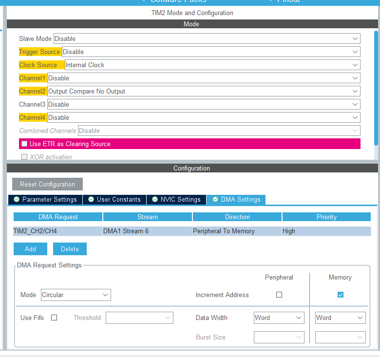

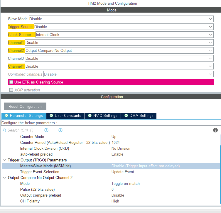

I need to generate PWM on a non-PWM pin
I know one method is to use an ISR triggered by a timer, but because I need to run the PWM at 10kHz, this will put a huge load on the CPU just to toggle 1 pin.
I've seen examples of using DMA to send data to the BSRR e.g.
https://github.com/mnemocron/STM32_PatternDriver
But following this example, on my STM32F407, the DMA does not seem to send a single transfer to the BSRR register, as the pin does not change
const int dimingTableSize = 100;
uint32_t dimingPattern[dimingTableSize];
memset(dimingPattern,0x00, dimingTableSize * sizeof(uint32_t));
dimingPattern[0] = GPIO_PIN_8;// set pin 8
dimingPattern[50] = GPIO_PIN_8 << 16;// reset pin 8
HAL_DMA_Start(&hdma_tim2_ch2_ch4, (uint32_t)dimingPattern, (uint32_t)&(GPIOD->BSRR), dimingTableSize);
HAL_TIM_Base_Start(&htim2);
HAL_TIM_OC_Start(&htim2, TIM_CHANNEL_2);
//TIM2->DIER |= (1 << 8); // set UDE bit (update dma request enable)
__HAL_TIM_ENABLE_DMA(&htim2, TIM_DMA_CC2);
I've tested the array and BSRR part simply using a for() loop to send the array, and the pin clearly toggles.
However using DMA, even if I set the first index in the array to set the pin, the pin remains reset, which indicates the DMA has done a single transfer
Can anyone see what I've done wrong.
BTW. I've tried other timers and other channels, but it didn't make any difference

also i just noticed your DMA is set peripheral to memory and it should be mem to peripheral.
you want the DMA to take values froma buffer and place them in the BSRR register of the GPIO peripheral dont you?

Thanks
Using DMA1 was the problem.
I know in the images I posted that the DMA was also set to Peripheral to Memory, I had already tried the opposite direction, and that didn't work either
I also had to use Timer 1, because TIM1 or TIM8 seem to be the only timers that can trigger DMA2.
In my case I could not seem to use TIM8 becuase of a NVIC conflict, possibly with the UART.
Anyway. Timer 1, CH 1, no output to physical pin, is now working.
@STM
I think you should fix the bug in the STM32 Cube which allows use of Timers other than TIM1 and TIM8 for DMA to peripherals, because on the other timers appear to all use DMA1 which can't communicate with peripherals
