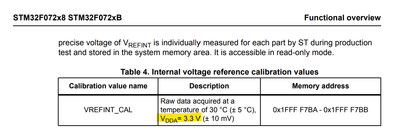

2024-02-07 8:11 AM
The VREFINT_CAL value is taken when VDDA = 3.3V. This is the voltage it's referring to.

2024-02-07 8:30 AM
Thank you TDK! I knew it was simple/*** on my part.
