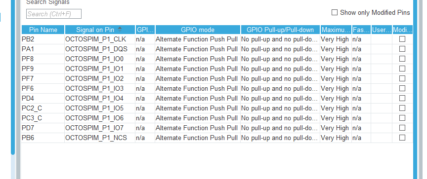

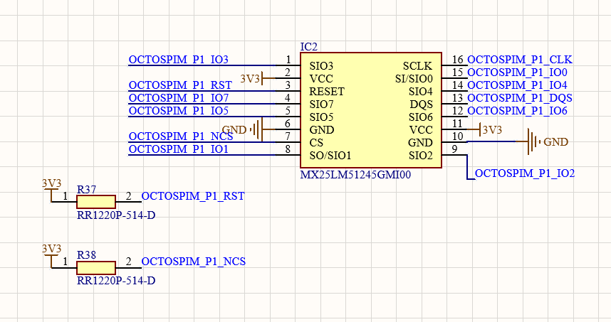

What is your pin configuration? The same as the DISCO board?
What are you trying to build? The .STLDR? A loader that runs in application space?
The ReadID is consistent with the data-sheet
https://www.mxic.com.tw/Lists/Datasheet/Attachments/8729/MX25LM51245G,%203V,%20512Mb,%20v1.1.pdf
2024-04-06 2:46 PM
not exactly the same pins numbers but it is connected OCTOSPI1, on disco board to OCTOPSPI2, the same memory chip.
I want to try STLDR later I have seen some codes on guthub. for now I want to get to write and read data. all those examples use HAL driver. so all is the same. I guess I am missing something, some FLASH configuration setup.

2024-04-06 5:18 PM
OCTOSPI1
2024-04-06 6:11 PM
