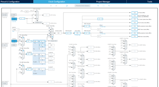

I have W25Q256JV and STM32L562CEU6 with 38 Pin Package and have OSPI (Single SPI, Dual SPI and Quad SPI option only). Below is my Clock Settings, OSPI (Quad SPI) with Quad Lines Settings and Error Status during Write Enable and main.c file.
Kindly check and let me what is wrong so it's going into Error Handler every time on Write Enable.
If any basic drivers are available for OSPI in Quad Mode for Read/Write/Erase.
Looking forward to your kind help...

Hello @NajeebUllahKhan;
What is the OCTOSPI frequency value?
Could you please try to decrease the OCTOSPI clock frequency.
Is the memory configured in memory mapped mode?
Thank you.
Kaouthar
2025-05-04 3:44 AM
System is running at 110 MHz and Prescaler is 2, so OSPI Freq is 55 MHz.
