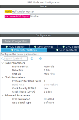

here my spi setting for ST7735 TFT :
What kind of TFT you have ? (I have green tab version.)
Is init ok ? TFT cls -> black screen ok ?
