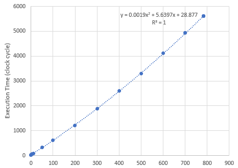

the execution time shouldintuitively has a linear relationship with the Size.
but in test, I've found that it is the square of the Size. The R is eventually equalto 1.
I test the function 10K times for every Size number. And got the average execution time for every Size value. So I'm sure the result I got is correct.
in the trend function, the real constant 28can be explained. which denotes the clock cycles cost by the function, push and pop stack and the parameters loading.
the linear coefficient 5.63 is also explainable, which denotes the clock cycles cost by every loop.
I don't know what's the meaning of the quadratic coefficient.

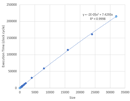

And then I increase the number of size. the quadratic coefficient close to zero the it looks become a linear curve.
But the quadratic coefficient increased from 5 to 7. Does that means the time cost for every loop, increase with the increasing of the size?
I draw a curve for the quadratic coefficient.
the Y axis means, when I draw the trend curve for the first several points in the first picture, the quadratic coefficient of the trend curve.

Thanks for your reply, Firstly for the cache, I know it takes less time before the cache is full. But according to My test, the fastest loop is not the first several loop but around 200. See
in the first several points, it is very slowly for every loop.
