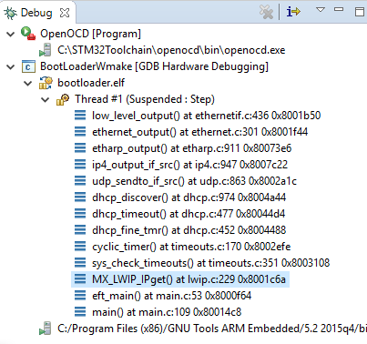

Also, I noticed the function low_level_output in ethernetif.c return an error. I go into this ''if'' function after 4 retries from DHCP stack :
/* Is this buffer available? If not, goto error */
if((DmaTxDesc->Status & ETH_DMATXDESC_OWN) != (uint32_t)RESET) { errval = ERR_USE; goto error; }But the error is not shown as udp_sendto_if_src doesn't take the returned status into account.
