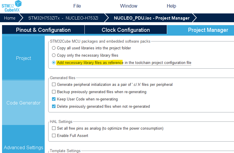

> STM has so many files under many directories (CMSIS, etc.) I didn't feel it necessary to add all these files.
This is because the default option in Cube is to copy all the library files into the project, and you've left it as is.
Since the libraries themselves became available on github, a smarter choice is to check out these libraries separately and use them as git submodules.
This allows to share the libraries among any number of projects and keep them away from your own repo.
Before generating a project in Cube, change the option to copy library files to references.
Of course, if you use managed Eclipse CDT projects (default for CubeIDE) - store the .project and .cproject files.
As TDK wrote, .ioc does not contain code and is not used after generation, so you can move it away to a sub-dir. I never keep mxproject files, IMHO they only cause trouble. /* How to re-generate after editing Cube stuff (pinout) is another long story */

Can you point me to the github link for the libraries? And I do not see the copy library files to references option under Project Properties option....Do I need to create a project first and if so should it just be a C project or should it be an STM project?

2021-06-30 3:29 PM
With pleasure. https://github.com/STMicroelectronics/STM32Cube_MCU_Overall_Offer
See below - this is for a standalone CubeMX, CubeIDE has something similar
