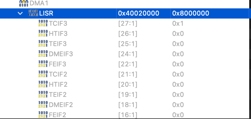

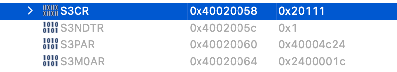

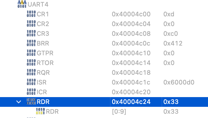

Hi everyone, just a question about this DMA not triggering for unknown reasons.
The only thing I can deduced is the switch from C to C++ and how variables behave within an object maybe.
All I know is the peripheral is working and the DMA is setting the right flag. I also tried the C version of my code and it worked. Double check the buffer is in the right memory region as well the RAM_D1.
For some reason it doesnt wanna hit the void DMA1_Stream3_IRQHandler(). Yes I used the
