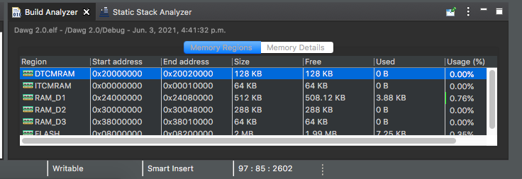

2021-06-04 9:54 AM
0x00000000240004ac is in the AXI SRAM.
0x0000000008000f60 is in FLASH, but that's just code, not a buffer.
Why do you think those are in ITCM?
2021-06-04 9:57 AM
Oh cause of this, weird
2021-06-04 9:58 AM
Right I see my mistake now correct its in the D1 Domain, what else could it be then
