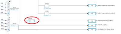

I created isolated test code with CubeMX v6.17.0 for STM32N6570-DK and STM32CubeIDE v2.1.0 to reproduce the issue. IOC file and code in attachment. Test code is in FSBL and it just blinks LED1 with 1 second period. When TIMPRE is 1 or 2, it blinks correctly. To reproduce:
Change TIMPRE to 4 or 8 in clock tree and generate + build the code:

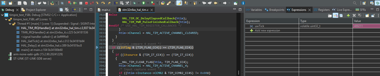

Launch the FSBL with debugger. Debugger should break at HAL_Init(). Press Run. Nothing happens. LED does not blink. Pause debugger and watch uwTick value:
CPU is busy in TIM6_IRQHandler and with few seconds, the count has reached 489211. CPU is busy serving only the timer interrupt request and can't do anything else - even finish the LED blink delay as seen in call stack.
