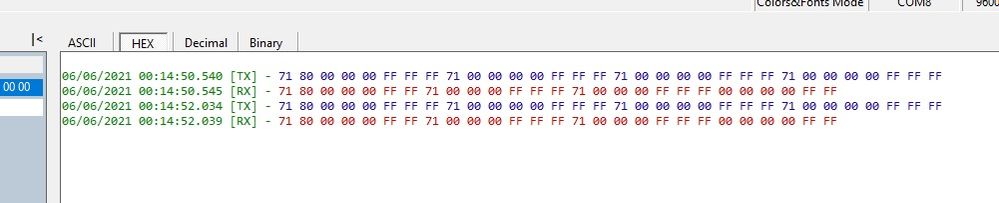

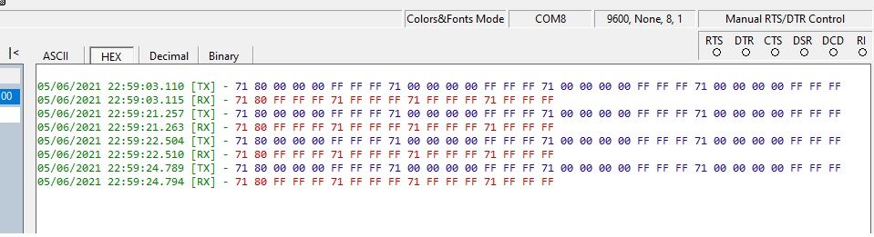

}Picture below is showing send data to MCU with blue color and received data back to the computer with red color. The null bytes are missing.
What can I do.

2021-06-05 3:04 PM
2021-06-05 3:14 PM
Note that this would have been caught had you been monitoring the return status from HAL_UART_Transmit.
2021-06-05 3:19 PM
OK so now I add HAL_Uart_transmit directly to the usart1 global interrupt handler. Is a little better but there are still some bytes missing.
