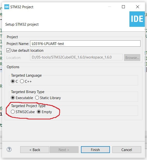

2022-02-12 8:39 PM
Hello.
I have the same situation. The RXNEIE interrupt for LPUART did not work until I replaced the startup_stm32l031f6px.s file with the same one from the STM32Cube project.
Thanks to @XKeto.1 for this workaround.
MCU: STM32L031F6.
IDE: STM32CubeIDE 1.8.0
LPUART_init.c
// Enable transmitter, receiver and receive-interrupt of LPUART1
LPUART1->CR1 = USART_CR1_TE | USART_CR1_RE | USART_CR1_RXNEIE | USART_CR1_UE;
