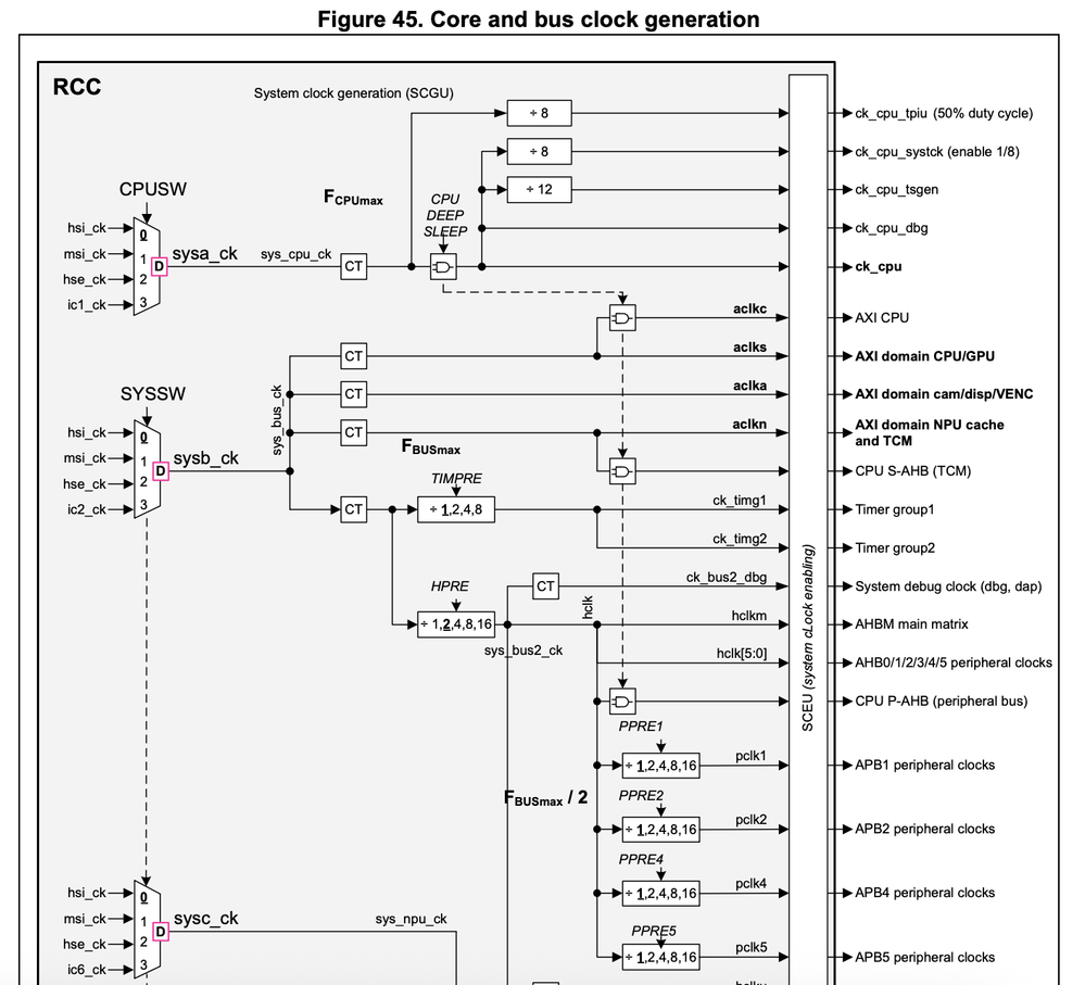

2025-08-19 10:45 AM
Hi @Franzi.Edo
My suggestions Iare:
1) Check the entirety of your clock tree configuration and RCC registers. I suggest also tu use STM32CubeMX to help you.
At the sysa_ck and sysb_ck levels (see figure below from RM0486), make sure that they are receiving the correct clocks from ic1_ck = 600MHz and ic2_ck=400MHz from PLL1 and the correct prescalers ic1 to ic11.
Regarding the timer you are using, also check the TIMPRE values. Check that your timer is clocked at 1MHz.
