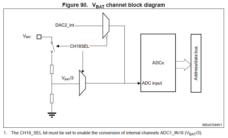

In the new design instead of using a voltage divider to an ADC pin can I use a connection from the positive terminal of the battery straight to the Vbat pin?
Yes. Possible.
Below is the image snapshot from
of the MCU.Couple of points:
2017-07-26 11:33 PM
Check the normal operating input voltage of vbat to make sure weather the battery can be direct connect to vbat pin or not. As i recall, the adc will have an inyernal divider to scale the voltage within mid range of the adc. It has a power switch to reduce leakage. Using vref adc channel, the accurate vbat voltage can be calculated properly.
If the vbat is 5v, it would probably require an external divider...
2017-07-28 1:33 AM
If the battery is 4.6V, the vbat gpio maynot be 5v tolerant, hence make sure not to beleive 5/3 will solve it...
