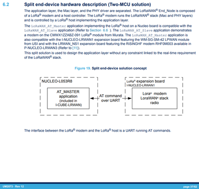

@SamyHaouaraUTC wrote:I would like to better understand what level of support and resources are available from ST for implementing such a solution in practice.
There aren't really any special resources or support necessary - just treat it as two separate microcontroller projects.
Most likely, they will just communicate via one simple interface; eg, UART.
An example would be the LoRa projects which implement an AT-command interface
via: https://www.st.com/en/embedded-software/i-cube-lrwan.html#documentation

For STM32WL you can consider the AN5554 while for STM32L4 you need to consider either to implement a custom bootloader or simply use the ST bootloader (AN2606) most probably using the UART interface and make STM32WL a bridge between the wireless server and STM32L4. Indeed you need to implement a mechanism that makes each of STM32WL and STM32L4 knows that the other MCU is going to be updated and synchronize with it.
