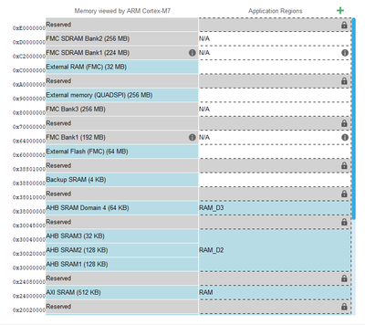

(attached reference images for context):
2025-11-16 12:15 AM - edited 2025-11-16 12:25 AM
The STM32H753 microcontroller features a Quad-SPI (QSPI) memory interface designed specifically for Single, Dual, or Quad-SPI flash memories. This interface supports up to 256 Mbytes of external flash memory and can operate in direct, polling, or memory-mapped modes. However, the official documentation does not mention support for PSRAM (Pseudo-Static RAM) or other non-flash memories via the QSPI interface. The QSPI is intended for flash memory only, and there is no indication that it can be used for PSRAM or RAM chips.
For connecting PSRAM to the STM32H753, the recommended interface is the Flexible Memory Controller (FMC). The FMC is designed to support static-memory mapped devices, including PSRAM, and can handle up to 4 memory banks. It offers features such as independent chip select and configuration for each bank, and supports 8-, 16-, and 32-bit data bus widths. This makes the FMC the appropriate choice for interfacing PSRAM with the STM32H753.

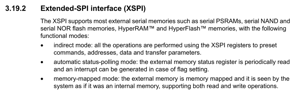

Maybe other idea: look at the H7S3 /7 series with xspi :

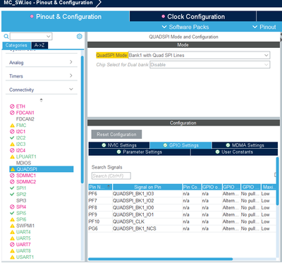

I Can't understand you sorry,
If I'm using QSPI for connecting PSRAM why the MCU cares about who connect to him? the MCU communicate with PSRAM on QSPI interface and that's all? I don't need it to be memory mapped, just to store data .

Ok, i see,could work, so read : AN4760
I would do a real test: if you have a nucleo board with H7xx , connect a small so8 adapter with short wires and test it,
with the issi PSRAM . Not much effort , but then you know it 100% .
2025-11-16 12:58 AM
ok thank you,
just want to connect it as "device" and we need driver, etc..

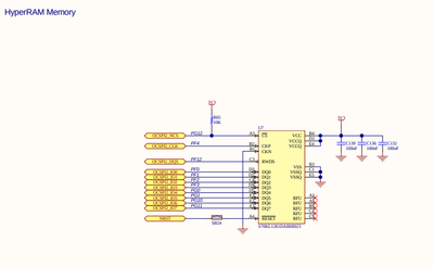

What i found: see MB1520b , H735I board :
with S70KL1281DABHI023
S70KL1281DABHI023 is a 128 Mb HyperRAM™ with DDR, 100 MHz clock, and 3.0 V I/O.
https://gist.github.com/thomask77/c65d7d1017e88ae0dd47d8b416fef0cb
external SDRAM, external SRAM or external OSPI-RAM for code execution
