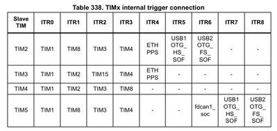

sSlaveConfig.SlaveMode = TIM_SLAVEMODE_EXTERNAL1;
sSlaveConfig.InputTrigger = TIM_TS_ITR2; // TIM3 -> TIM4 (ITR2 on H743)
HAL_TIM_SlaveConfigSynchro(&htim4, &sSlaveConfig);
