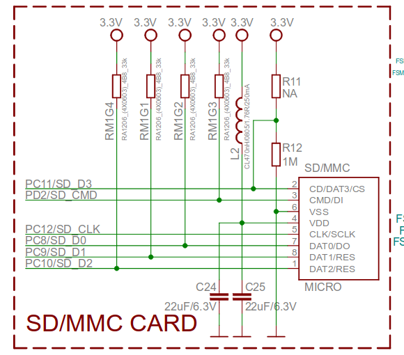

But, as I see, for example, Olimex dev board with stm32f407 MCU:
Pullup resistors have value 33k, which is not so far from internal pullup value(~30-40k - am I right?).
