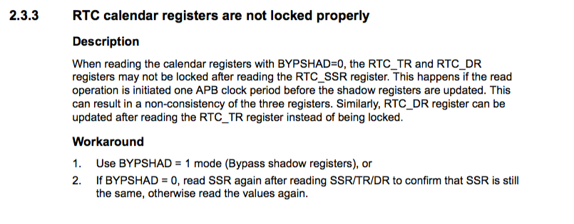

try RTC->CR->BYPSHAD = 1 and read the registers again because the shadow registers are not updated during stop or standby. otherwise, wait for RTC->ISR->RSF to set.
Checking out the F446 errata RTC section might help too:
