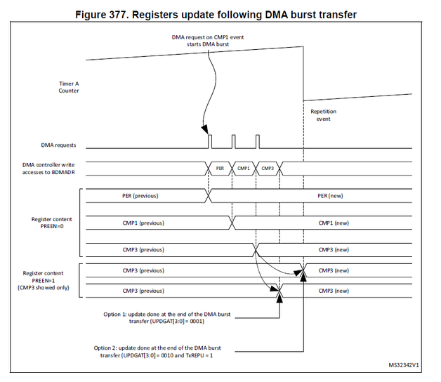

When the preload is enabled (PREEN bit set), there are 3 use cases :
If you want to update registers on the timer reset, you should have a look on this figure (especially the option 2) :
Did I answer your question ?
Best Regards,
