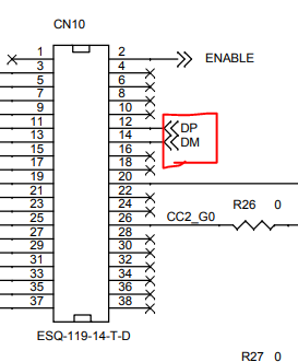

1. after adding the X-Nucleo Drp1m1 board to the Nucleo U575 board and following the same pin connection as you mentioned earlier and we added the D+ and D- pins with jumper wires.data transfer and code flashing are not working. Could you please guide me if there is any hardware connection Or any usbpd configuration we might have missed?

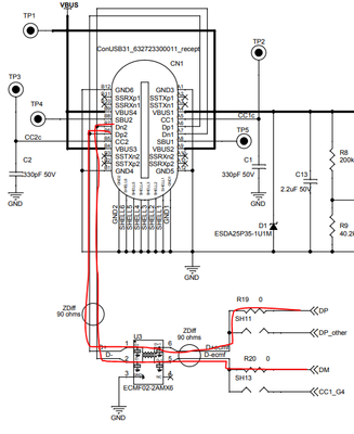

1- I suppose you connected D+/D- from X-NUCLEO-DRP1M1 CN10-12 and CN10-1.
If yes, this is correct, R19 and R20 are present.
The difficulty I see is that using free wires we don't respect anymore the 90Ohms differential pair.

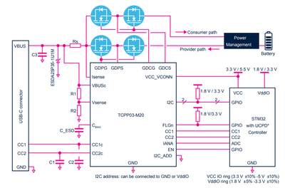

2- I confirm, the battery charge has to be managed from the X-Nucleo-DRP1M1 sink (screw terminal).
Here is an application block diagram:
Best regards
Pascal
