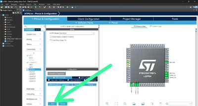

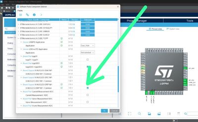

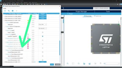

1. **X-NUCLEO-DRP1M1 options not appearing in STM32CubeMX for STM32U575ZI:**
We are unable to enable the X-NUCLEO-DRP1M1 options in STM32CubeMX for STM32U575ZI, as shown in the video tutorial (see attached picture).

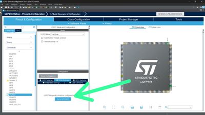

2. **DMA configuration not available for STM32U575ZI:**
While the DMA options are available and configurable when using STM32G071RBT, they do not appear for STM32U575ZI. We are unable to enable DMA options for Nucleo board STM32U575ZI, as shown in the picture.

2024-11-14 3:01 AM
Dear NajeemSyed
X-NUCLEO-DRP1M1 are in Nucleo-64 form factor so it is dedicated to be plugged directly on a NUCLEO-G0xx or G4xx.
this is ony in this case that you can use the X-NUCLEO-DRP1M1 BSP.
Then in your case, you have to define required resources :
- I2C
- GPIO Out for Enable
- EXTI for FLAG
- At least 1 ADC Channel for Vbus
And in the X-Cube-TCPP software pack, "Platform settings" affect these resources to the application requirements.
The video is using STM32G0xx MCU in its example. This MCU is using DMA,
For STM32U5 go to the GPDMA page.

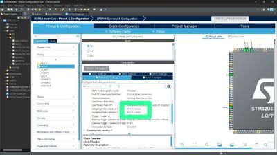

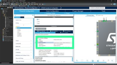

We followed the tutorial from the STM32 website (link provided below). However, after following the tutorial(custom board / other than G series necleo board) ,the module not works as a dual-role device. I have attached a battery to the source terminal, but if i connect device to module that devices are not powered by the module.
Key Differences in implementation steps in the link
ADC Prescaler Setting
- In the tutorial, the ADC prescaler is set to "Synchronous Clock Divider by 4," and "Sampling Time Common 1" and "Sampling Time Common 2" are configured with 160.5 cycles. However, this option is not available for the STM32U575ZI necleo board.So ,Instead of the above points We used "Asynchronous Clock Divider by 4." And Configured "Sampling Time Common 1" and "Sampling Time Common 2" to 814.5 cycles.

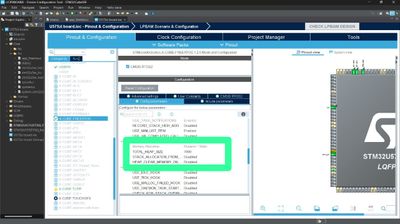

Free RTOS
- We allocated 7000 bytes for FreeRTOS heap memory, as per the tutorial.
- The tutorial specifies the CMSIS V1 interface, but this option is not available for the STM32U575ZI necleo board in stm32 cube IDE.

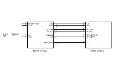

Please find Attached are images of the tutorial, our IOC configuration, and the schematic of the USB connections.
Please review and assist us in moving forward with the implementation of USBPD dual role. Could you also guide us on the necessary steps to connect the X-NUCLEO-DRP1M1 board with the NUCLEO-U575ZI-Q? Specifically, we would like to know the required hardware and pin connections for this setup.

2024-11-27 5:48 AM
Hello NajeemSyed
All the differences you noticed are normal and MCU dependant.
Your ADC Configuration looks good, maybe you can reduce the sampling time to a medium value (My setting : 79.5 Cycles). But this is not critiical.
Your are using "X-CUBE-FREERTOS" because native FREERTOS (used for the G0 demo) is not available for this MCU.
Please can you try with Native ThreadX instead ?

2024-12-02 10:59 PM
Hi Rajkumar24
1- We are working on the issue you are facing about X-CUBE-FREERTOS on USBPD applications for STM32U5xx. For the moment I would advise to make your first tests using AzureRTOS. We will come back to you with a solution.
2a - For dual role PD functionality using the X-NUCLEO-DRP1M1.
- First you have to disconnect the CC1 and CC2 lines of the UCPD periheral to re-route them to the DRP1M1.
To do this the best for me is to unsolder the TCPP01, because you can open the CC1 line opening SB42 but there is no way for CC2.
- Then you have to affect with free wires:
from X-NUCLEO-DRP1M1:
- 3V3 (SN7-16) to the NUCLEO-U575IZ 3V3 (CN8-7)
- I2C_SCL (CN10-3) to a NUCLEO-U575IZ I2C-SCL (for example I2C_A_SCL (CN7-2)
- I2C_SDA (SN10-5) to a NUCLEO-U575IZ I2C-SDA (for example I2C_A_SDA (CN7-4)
- ENABLE (CN10-2) to a NUCLEO-U575IZ GPIO Out
- FLG (CN10-37) to NUCLEO-U575IZ GPIO EXTI
- CC1 (CN10-17 or 23) to the NUCLEO-U575IZ CC1 (CN11-17 = PA15)
- CC2 (CN10-26 or 27) to the NUCLEO-U575IZ CC2 (CN12-26 = PB15)
- ADC Vbus (CN7-28) to a NUCLEO-U575IZ ADC Channel
Optional:
- ADC I (CN7-36) to a NUCLEO-U575IZ ADC Channel
- ADC Vprov (CN7-30) to a NUCLEO-U575IZ ADC Channel
- ADC Vcons (CN7-32) to a NUCLEO-U575IZ ADC Channel
