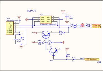

2024-01-29 5:11 AM
As said @Andrew Neil , you can refer to the AN4206 and AN4879. But also, you can use the Schematic Pack of the STM32373C-EVAL to inspire for your design:
Best Regards.

2024-02-04 5:04 AM
this type configuration is upstream right? why i should use this design ?
2024-02-04 7:03 AM
You don't have to use this exact design. You just can inspire from this design and other ressources to do your own design.
Best Regards.
STTwo-32
2024-02-05 11:19 PM
What do you mean by "upstream"?
USB talks about "host" vs. "device": a host provides also power (on VBUS, where a device consume the USB power (VBUS).
There can be a pull-up/down (?) on one of the USB signals (DP vs. DM): it tells the host if the device is a FS or HS, or it if it is connected. You have to check if such a pull-resistor is already provided in the MCU you use.
The schematics you got here shows you an approach to "toggle" a pull-up, assuming used to announce as: "device is not available" (for a host, "USB_disconnect").
The U13 is just to protect the USB inputs (a array of diodes to deal with inverse polarity or signals getting above allowed signal level).
There are so many STM board schematics out there with USB circuit designs. Just check it, compare it, understand it.
BTW: when you want to design your own PCB with USB: it is not very trivial: USB is "differential signals" with correct impedance (90 Ohms). A wrong PCB layout, e.g. not matching the impedance for the differential signal can result in "not working" (too many bit errors on USB).
