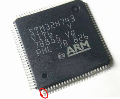

> I have a known bad solder connection (trace compromised). I measured 2.3V on this pin.
All VDD pins need to be supplied externally. The internal network will try to maintain this, but it's not guaranteed.
Perhaps you have it misoriented. If text is oriented from left to right as you would read it, pin 1 is on the bottom left.
